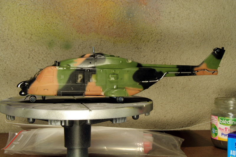

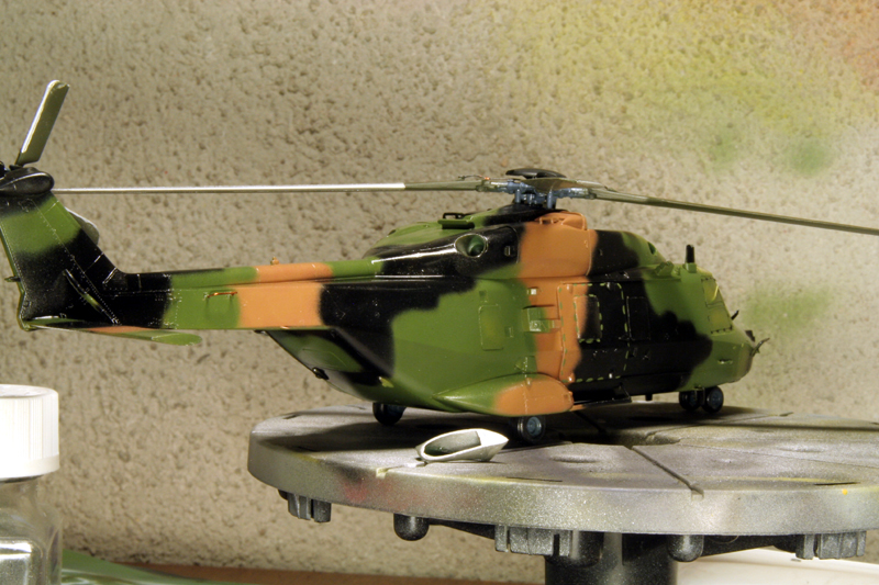

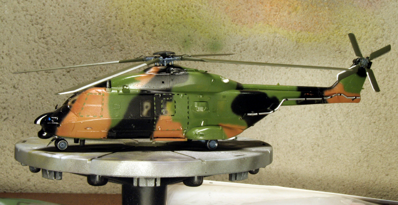

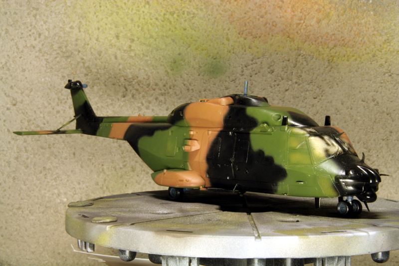

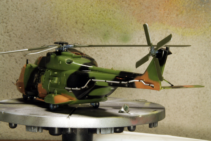

Stage 3 : the painting
Stage 3 or my tatonnements to find the good colors! At the beginning of the stake in paint with a blow of apprêt
Aprés the sanding of the diverse joints, I began the installation of the equipments of missions
First attempt for colors
We see in front a too green green and behind a too dark green... New essay and...
And finally the last one where I think of having found the compromi check. It is the one that I keep.
And here is from now on you will follow the editing at time real.
thus not too fast the morning and slowly the afternoon.
See you
Xanathos

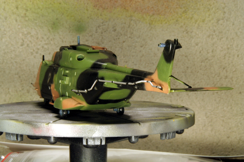

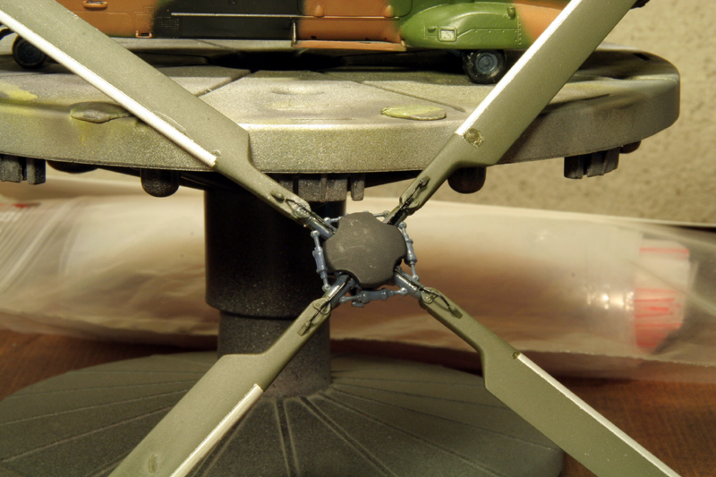

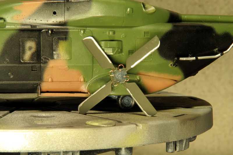

Good evening.As you can see
Good evening.
As you can see it, I have a small problem with my host of photos.
For the moment I had no time to correct everything, but I was anxious to make you share the last progresses of the assembly.
I took back the weak, and to add supposed cable to hold the weak of the rotor anti-couple back.
I painted in hand sunrise the frames of emergency exits, I can say to you that it is not simple!
I think of printing the decalcs makes house tomorrow so that they indeed have the time to dry.
I have an antenna believe it to put and to paint the small antennas on the beam of tail.
Good evening in all
Xanathos

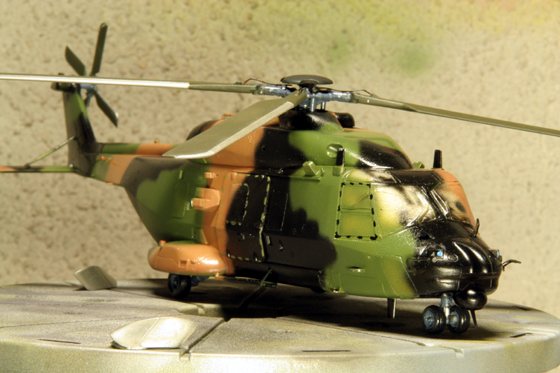

Xanathos's picture

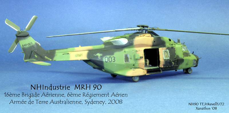

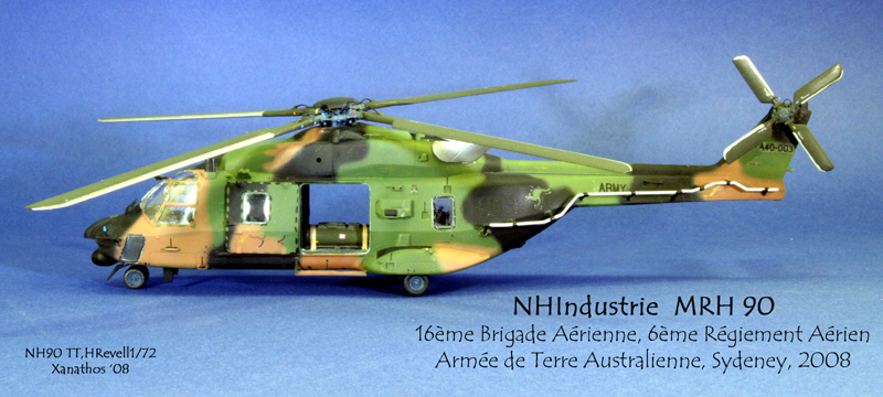

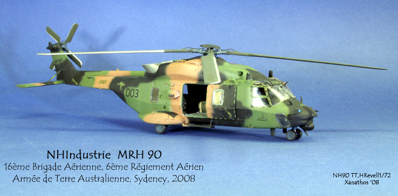

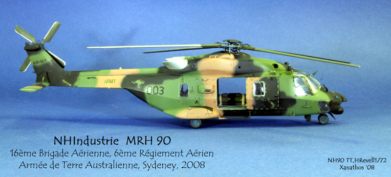

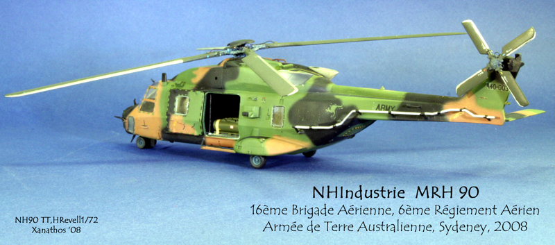

Hello Everybody And here is
Hello Everybody
And here is my last helicopter of the year finished!
It will have been my twenty the third model of the year, a happy good year at the level model!
By hoping that this assembly pleased you.
See you
Bye
Xanathos
Bladerunner's picture
Very nice NH-90
Hi Xanathos,
I like your NH-90. You did a great job. Nice to see how you did the camo, because I'm planning to build an Australian RAH-2 Tiger soon. Thanks for sharing.
Cheers
Bladerunner
Xanathos's picture
Hi Bladerunner for the Aussi
Hi Bladerunner
for the Aussi Tiger you can use the Hobby boss Box, the paint plan are goods.
Thnak foryour reply
Xanathos
RAH-2 Tiger
Hi Xanathos,
I'm going to convert the 1/72 Revell Tiger UHT/HAP kit (very nice kit), and I have a lot of photos too. I will post it in the forum when ready. The camo on your NH-90 looks good, and doesnt ruin the pleasant lines of the model.
RAH-2
Cheers
John
norbert's picture
Hi Mate, you did a great
Hi Mate, you did a great job  (I was not far to say a F** great job)
It's a pleasure to see this model finnished, was it the one we spoke over the colours in Hyeres ?
I din't know those helicopters were based close to Sydney. Nice lady in any case.
Norbert
Xanathos's picture
Hello Norbert.Indeed it is
Hello Norbert.
Indeed it is the one that I had brought to Hyères.
For the air base of Sydney, I based myself on Wikipédia and on the organization of the Australian army. The Australian light aviation is based on Sydney according to wiki, I found nothing of the other one.
In the pleasure
